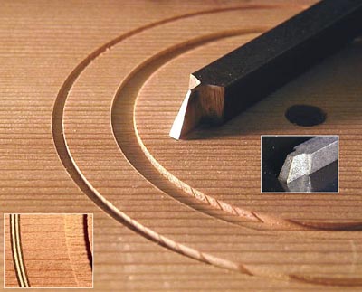

PostPosted: Wed Jan 25, 2006 4:18 am
Posts: 183
Here's how I ground a couple of the bits.
PostPosted: Wed Jan 25, 2006 5:13 am
It was Pete. Nice work Mr. Licis. These young bucks gotta see a pro do it and then they can, "Walk this Way!"
